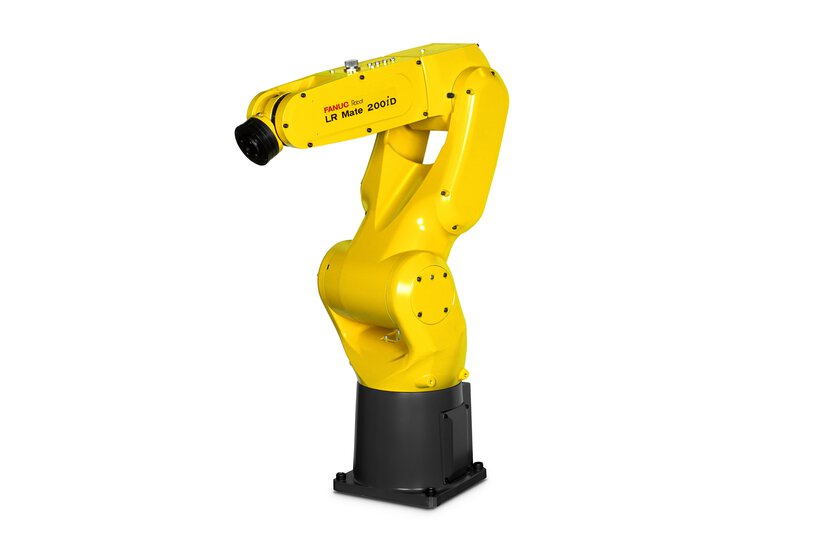

A trio of class-leading industrial robots from FANUC are now fully operational at Swissmint: LR Mate 200đť‘–D, LR-10đť‘–A/10 and M-20đť‘–D/25 models. The robots fulfil important roles such as packing coin rolls, erecting boxes and palletising. Regarding the latter task, the solution takes advantage of FANUC PalletTool® software to expedite the set-up of uneven palletising patterns.

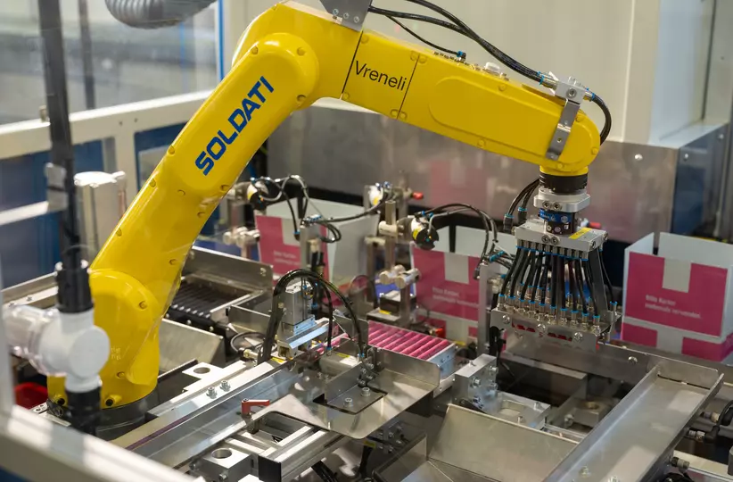

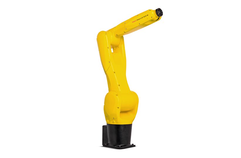

Handling of coin rolls by LR-10iA/10.

Regarding the various phases of system automation at Swissmint, minted coins are transferred to the first robot cell in individual rolls that have already undergone processes such as weighing and printing (on the roll exterior).
Within the robot cell, coin rolls are aligned at high speed into complete layers before a FANUC LR Mate 200đť‘–D compact industrial robot picks 10 rolls simultaneously and places them into boxes. The boxes have already been automatically grasped, erected, stapled and transferred to the coin roll packaging system with the assistance of a FANUC LR-10đť‘–A/10 compact industrial robot, which is ideal for a variety of vertical picking and machine-tending applications.
 The system subsequently closes the flap of each box individually prior to strapping, weighing and printing operations. The boxes then see transfer to the labelling unit.

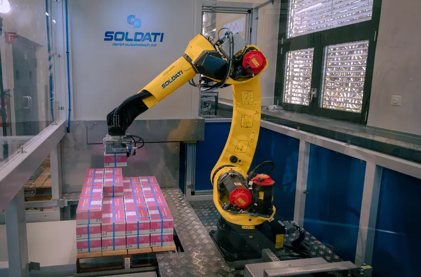

 Another particular challenges was facilitating the unusually uneven palletising patterns required by Swissmint. Here, a special robot gripper and palletising program, created with ease using PalletTool® palletising software from FANUC, makes light work of this otherwise complex task. With the PalletTool® program, a FANUC M-20đť‘–D/25 industrial robot uses its high-speed motion and proven repeatability to place the small but heavy boxes in the correct positions on the pallet.

Palletising of boxes of rolled coins by M-20iD/25.
